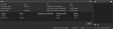

My problem is that I've tried with using Constant bitrate, Variable bitrate, and none of them seems to work for me, I tried lowering the scaled resolution, lowering the fps. the thing is that when I start streaming, the first 5 seconds looks like It works just fine, but then at 10-15 seconds the bitrate starts going crazy, I set it to 4000 or 4500 in CBR but when I'm streaming I see it goes to 7000 bitrate and then drops to 2000 bitrate, this causes me like a 25% to 60% dropped framerates sometimes.
Could this be a problem with my isp? and if it is, which problem could it be?

Your bitrate is stable. The amount of upload bandwidth between your computer and the server you're streaming to is not stable which results in dropped frames. OBS can help by dynamically changing the bitrate based on the amount of bandwidth available.
Before you start streaming, go to Settings, Advanced, Network, enable "Dynamically change bitrate...", [Apply], [OK]
This only works on RTMP streams, not RTMPS. Also make sure you are not using Twitch Enhanced Broastcasting.
If still having issues then post log as stated above.

I enable Dynamically change bitrate as you said and It says no framerates were dropped, but when some friends saw my live they told me that it was still blurry, like if there were actually framerates dropped.
I'm sending you the log file of it
I tried doing some changes too but still the same, I tried it while playing world of warcraft (Not a heavy game)
It gets blurry because the bitrate drops to as low as 1600. YouTube recommends 12000 bitrate for 1080@60FPS for a reason. Twitch recommends 6000 and you're sometimes providing < 1/3rd of that. Try lowering the bitrate in your vertical stream to free up some bandwidth for your Twitch stream. You can also lower your output resolution and frame rate.
