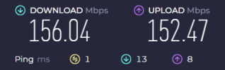

1.) Internet Speed :
1770817284766-png.118285

Your bitrate is way too low, youtube supports up to 51,000. Also youtube reencodes your video and will make it look worse on its own, you can avoid some of this by setting your output resolution to 2560x1440.
Ohkay, so up to what bitrate should I set mine to which can be handled by my internet? Also I am not getting an option for setting it to 2560x1440. My monitor is only FHD 1920x1080 60hz. Could that be the reason for it?
